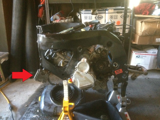

Billy, I didn't use a bracket
1 Attachment(s)
Re: New rider chic looking to meet other girls , lowell ma 06gixxer600
here's a picture of where i mount my rectifier.
i know the factory setup has a bracket there for the horn. i just used a 10mm nut into one of those threads for the bracket & run the wiring through the side of the frame.
NOTE: dont pay attention to the broken frame
Attachment 34858
