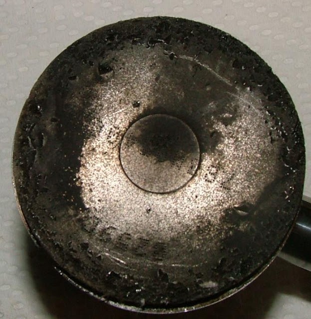

    Just to put it in perspective and give you an idea what to expect... Mine was having detonation issues.
    Piston:
    Head:
    Cylinder:
    That cylinder was in really good shape, even with the head and piston being that bad. All I did was piston & rings, even re-used the original head. Been running like a top since, including a beating @ Southwick, which is as hard on a 125 as anywhere I've ever ridden.

    IMO - That doesn't look like detonation damage. It looks like it ingested some hard parts...

    Nope, That's textbook detonation. Random pocking, plus fuzzing towards the outer edge of the squish band. A foreign object leaves a much more regular and geometric pattern, especially toward the outer edge, where it would be deeply imprinting the head and piston. We could likely identify the part from the impressions left behind!
