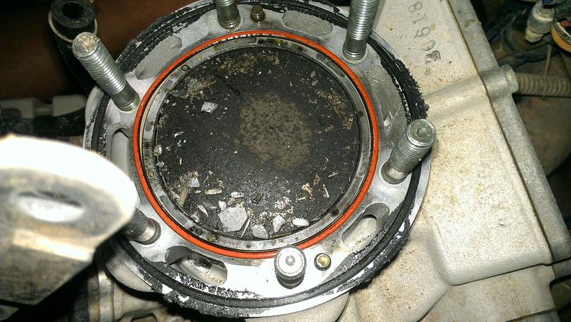

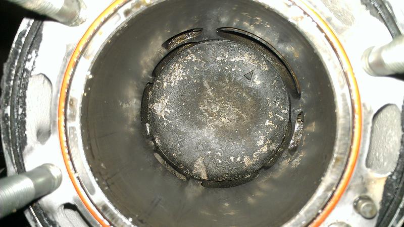

    Well boys, something definitely broke haha. When I drained the coolant it came out the color of Ice Tea which i have never seen. Took off water pump cover and impeller and all seems well. Removed the head and there was just a bunch of large chunks of metal. With a couple stomps on the kick lever I got the piston to go down from TDC. I have to get some more tools before I can remove the cylinder. This sucks something serious.
    Got my first dirtycycle!-imag0058-jpgGot my first dirtycycle!-imag0059-jpgGot my first dirtycycle!-imag0060-jpgGot my first dirtycycle!-imag0062-jpgGot my first dirtycycle!-imag0063-jpgGot my first dirtycycle!-imag0064-jpg

    Looks like cylinder needs replating, and obviously a new piston. Good news is it looks like it was a top-end blowup, as opposed to a bottom-end blowup. How deep are those gouges in the cylinder wall?

    I can't tell yet where that material cam from, but it doesn't look catastrophic yet. Get the cylinder off and take more pics. Certainly, the head and cylinder can be restored to health for short money.
    7,791
    Re: Got my first dirtycycle!
    huh, interesting pics... so this just occurred when you refired the bike and it then 'seized up'? any sounds or weirdness when it stopped running? i agree the head and cylinder look almost fine. won't take much to get those parts in shape.
    very curious where/what those shards are from. got pics of those on their own?

    Yeah I am curious where that metal came from too. Depending on how deep the scoring is you might be able to get away with just a replate. Check with Yamaha before you get a replate though. I know for my CRF450 it was cheaper to buy a cylinder new than it was to have my old cylinder replated.

    Are those pieces of metal reeds on the piston?
    I Have to go buy a couple of tools today/tomorrow and will dig further into what happened. Probably going to pull the motor out regardless and try and clean all debris out without pulling it all apart but I'm not sure yet.
    2000 RC51
    ok, these pictures pump me up...
    so if you have debris that's just on top of the piston and there aren't chunks of the cylinder in it, I would guess the bits and pieces either came from:
    1.) the intake side (pull off the carb, unbolt the reeds, and inspect for missing pieces...or check to see if there was a hole in the air filter and something got sucked in
    2.) the exhaust side (take off the cover for the exhaust valve, and check to see if the piston was smacking the exhaust valve, or if something broke loose in the assembly)
    so that could explain the debris, but what I'm still curious about is: why did it seize?
    when you kick over the engine - does it turn over smoothly? or is it rigid?
    Also, take off the cylinder...slide it off gently, take a peek onto the crankshaft to see if there is any debris, and check to see if the engine spins smoothly. After you check - stuff that opening with a rag to make sure nothing else falls in
    usually seizure means you have something's wrong with the crankshaft or transmission...but if the debris was just in the combustion chamber, it shouldn't have gone past there into the bottom end. So wtf is going on?
    Also - you said the coolant was dark - I'm not sure how that's related since it's a sealed system. Unless you have a hole or leak somewhere, that coolant shouldn't interfere with your engine seizing...maybe it was brown because it wasn't ever changed?
    good news: if it's just the debris causing your trouble, I'm guessing top end replate, new piston and rings (which you were going to do anyways with a "new-to-you" dirt bike), cylinder head machining, and gaskets...not too expensive. Maybe a $200 for a replate, $65 for piston/rings/pin/circlip, $55 for machining the head, and $30 for gaskets.

    It's a relief to see the problem up top. That jug actually looks ok from the pics. The metal has to be reeds, I really don't see what else it could be. It's a weird one for sure! Best of luck and keep us posted!
