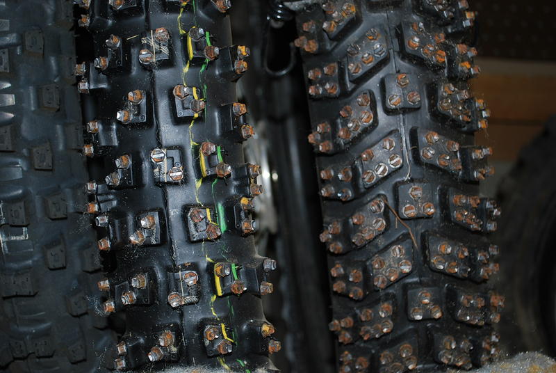

    If anyone is interested I've got a set of dual sided AMA tires for sale, used maybe 4-5 times. $300 for the set. 19 rear and 21 front. You can email me at info@woodcraft-cfm.com if you're interested.
    I've also got a set of studded MX tires for sale for $150....good shape. These are great for woods riding all winter long, we've been doing it for years. Also 19 rear and 21 front.

    I've been down the road of making them myself.....unfortunately they never work close to as well as the Fredette tires. Best of luck though.... the only way to be even close is to line your tire with another tire and screw right through them both. From personal experience, the ones that go only as deep as the knobs on your tire rip right out after while.

    For what it's worth ...here are photos of the tires that I have.

    Yeahhhh, I'd love to pick up some dedicated ice tires but it's just more than I"m willing to spend right now.

    fwiw I have a set of Erics old ice tires. Way better then making them yourself especially if you dont know how to make a proper ice tire.
