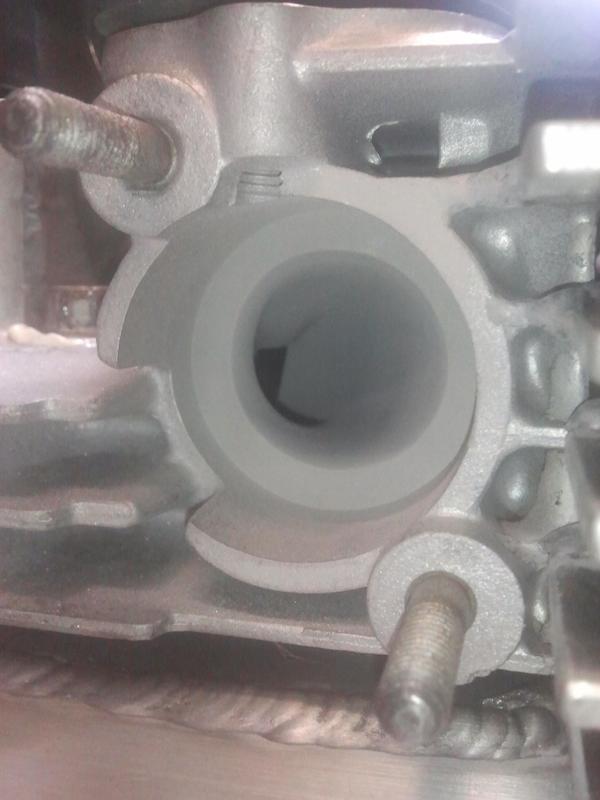

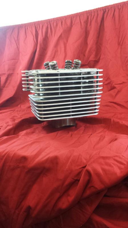

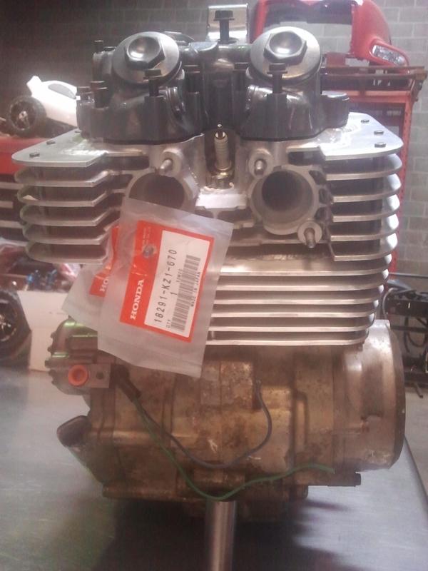

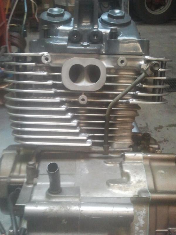

    So I had some spare time and a motor laying around. Next thing I know I have spent a bit too much on a 30 yr old motor. The bottom end has been thoroughly checked out and is in good shape. All the upgrades were in the top end.
    XR's Only did the following:
    Timing chain
    Web Cams trail grind hard surface cam
    Hard surface rockers
    Kibblewhite Stainless valves
    Kibblewhite hi-po valve springs w titanium retainers
    Jug was overbored 3mm
    Extended cooling fins welded onto the jug (custom, never been done by them before)
    Extended fins welded onto the head
    Trail port job
    Ceramic coating of the combustion chamber, back of the exhaust valves and inside the exhaust ports
    Pics of work from XRs Only-v__ed48-jpgPics of work from XRs Only-v__a8e4-jpgPics of work from XRs Only-v__8ff2-jpg
