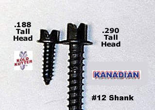

    If you're thinking simple screw-ins, fuck the Kold Kutters. If you can find 'em, go with Kanadian Kutters. I used them years ago on the Raptor and noticed a HUGE difference from the A-typical Kold Kutter.

    Thanks for the advice. I was looking at the stock tiers more because they had good size knobs on them to put some screws in. I'll use the correct terminology going forward thanks.
