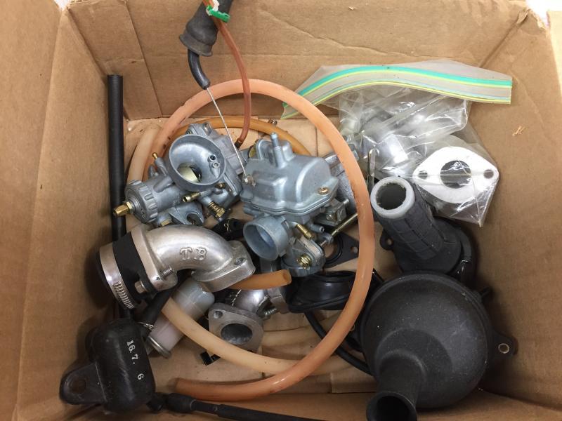

    Dug out my carb box, I've got a Mikuni VM26, 'Oko' 26, and a Keihin PE28. I actually had good luck with the Oko on my 160 build, it uses a mismash of Keihin and Mikuni brass. I *think* I was monkeying with all three trying to coax one to behave on my TT-R 125 but just didn't have enough motor to make good use of them. You're welcome to play with any of them.

    sweet ! thanks for digging this stuff up ! let me do a little research and i'll get back to you. the Oko was on my radar as well ... i'd really like to ditch this Lifan 125 and go bigger but it's brand new and in the bike so i'm on the fence. i hate the trans for my use, unsure i want to build off of that base.

    Josh, thanks again for the pics + offer but i've secured a Mik VM26-606, jet kit, UNI filter and CDI ... now to figure out what shock i can swap in
