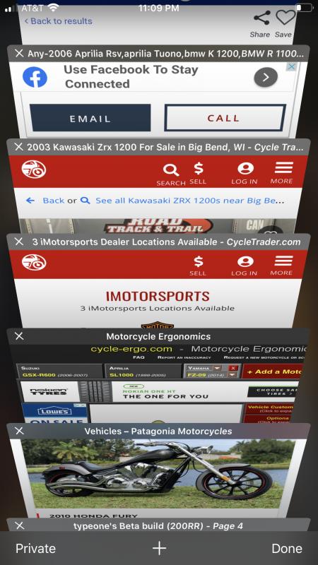

Meanwhile, look at all the windows I have open trying to FIND a bike :bitchslap:
Attachment 52115
