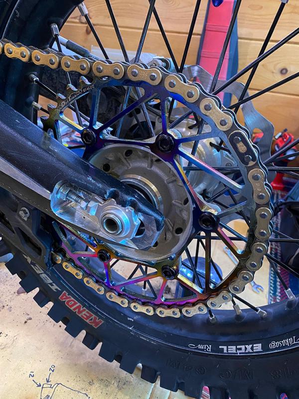

and my (-1T) rear sprocket dropped acid.. .
http://www.imgrepo.org/web/img/typeo...nt-2021-18.jpg
