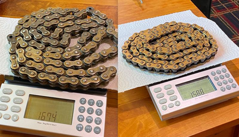

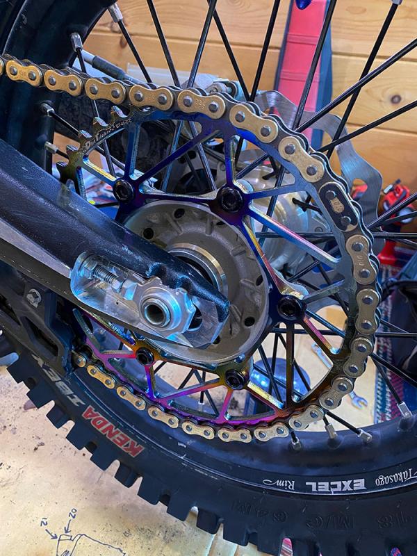

    since i'm experimenting with gearing i bought a cheaper steel rear sprocket but it was a re-tagged Honda sprocket. some Beta riders use them but the bolt holes aren't perfectly centered. no clue why you would force a sprocket to fit
    i love Dirt Tricks Ironmans, last forever, but 48T is not common and couldn't get black without a special order. the Chromatic was a random they had in stock so i grabbed it. thought i'd hate the color but it's actually kinda funky. changes from dark to light depending on sun.
    for the chain, i've been running the DID narrow x-rings for a while and love them. like zero wear, never needs adjustment. i've only had to replace one due to the side plates wearing down due to shot chain sliders and guide ... since this is a small motor, and to save a few bucks, i'm trying a DID non x-ring, curious how it will wear.
    the weight difference was surprising, only 89g (3oz) difference
