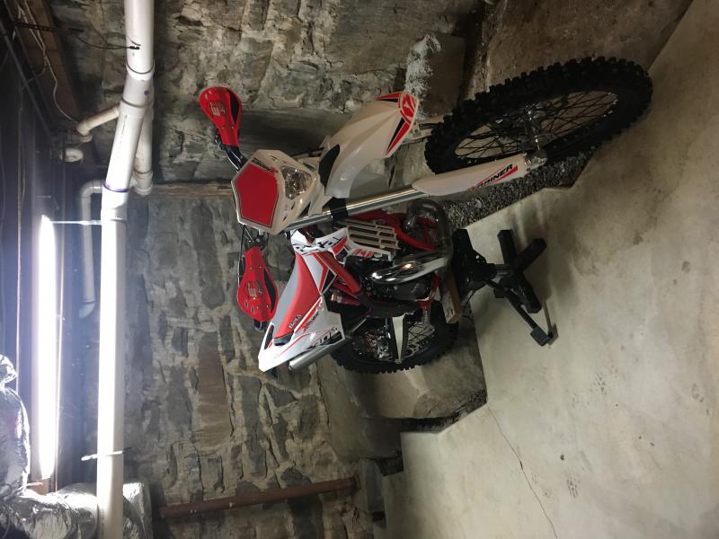

    Pictures or it isn’t happening! I always enjoying seeing your posts of such perfection in maintainance.
    Mine is stuffed in my basement for the winter, no plans to work on it.. lol
