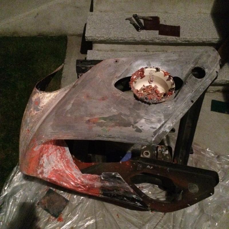

    I don't usually strip on Thursdays but...
    03 SV Track Bike Build-img_3938-jpg03 SV Track Bike Build-img_3939-jpg
    Taking off the layers of paint seems to be pretty easy with this cleanstrip paint stripper. First I gave the air DA a shot but the contours were too difficult to get into. There are a few cracks that need to be patched and filled. Should be painting next week. Any suggestions for high quality spray paint? I may just plastidip it for the remainder of the season and get crafty over the winter.

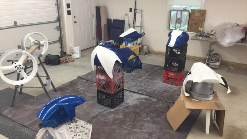

    The track bike went into hiding for the winter but came out for MDW and got a lot of bodywork done. If I didn't mention before this stuff should have gone in the garbage. There were so many bad cracks and damage but I went for it anyway. I used duplicolor perfect match spray bombs form autozone. Here are some progress pictures.
    Lots of glass/bondo work and shaping/sanding
    03 SV Track Bike Build-img_0843-jpg
    Primer coats
    03 SV Track Bike Build-img_0844-jpg
    Started to get windy, had to move inside
    03 SV Track Bike Build-img_0848-jpg
    Sprayed the blue first and taping off for the white here
    03 SV Track Bike Build-img_0856-jpg
    Color all sprayed
    03 SV Track Bike Build-img_0853-jpg
    03 SV Track Bike Build-img_0857-jpg

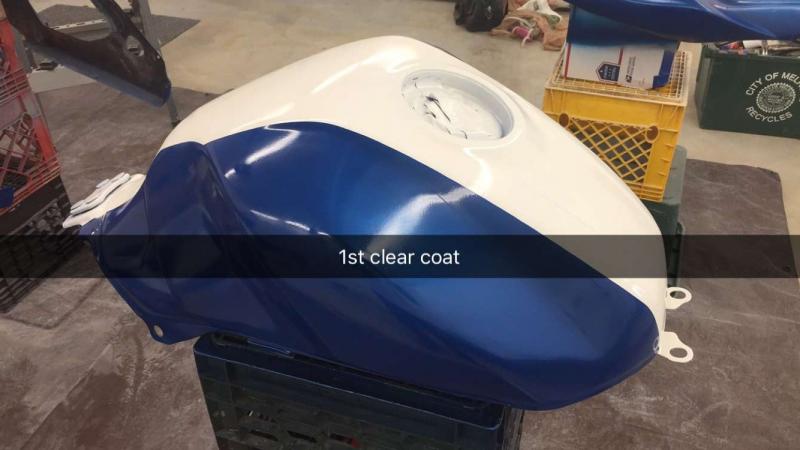

    First clear coat
    03 SV Track Bike Build-img_0854-jpg
    Second coat clear all sprayed
    03 SV Track Bike Build-img_0855-jpg
    Hope to compound and buff some night this week. Everything came out awesome considering what I started with. I spent a lot of time on prep work which really makes a difference, probably too much time for a track bike but I like to make things look good.

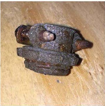

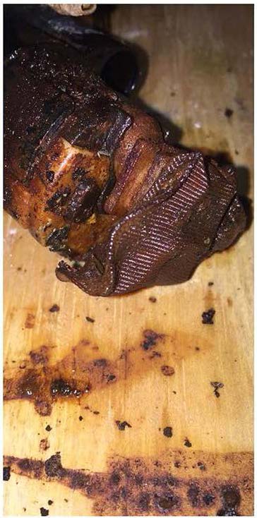

    Have made a bit more progress on the bike - test fitting the fairings and very pleased with the results. Also reminded myself what interesting artifacts I found in my fuel tank when I disassembled over the winter. The disassembly resulted from the one track day I had last year on this new to me bike at the time. The bike was having fueling issues at WOT above ~6-7k rpm in gears 2nd and up. What I found was caked rust all around the fuel filter which I proceed to clean thoroughly and reassemble, I believe this to be an ethanol issue. There is a distinct line in the tank where almost a layer of water looks to have rusted the tank slightly. No heavy or loose rust so I buttoned it back up. The most amazing find was a good sized bolt as well as an electrical fitting that belongs on a electrical box. Very odd. I have to imagine they fell in on accident while the cap was open. I have not tested the bike yet but am confident the acceleration problem was due to these issues. Looking forward to Loudon on Monday to get back to the track for the first time this season and get both bikes' thermosman suspensions adjusted.
