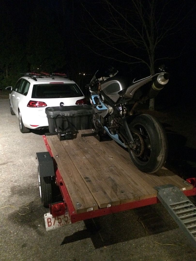

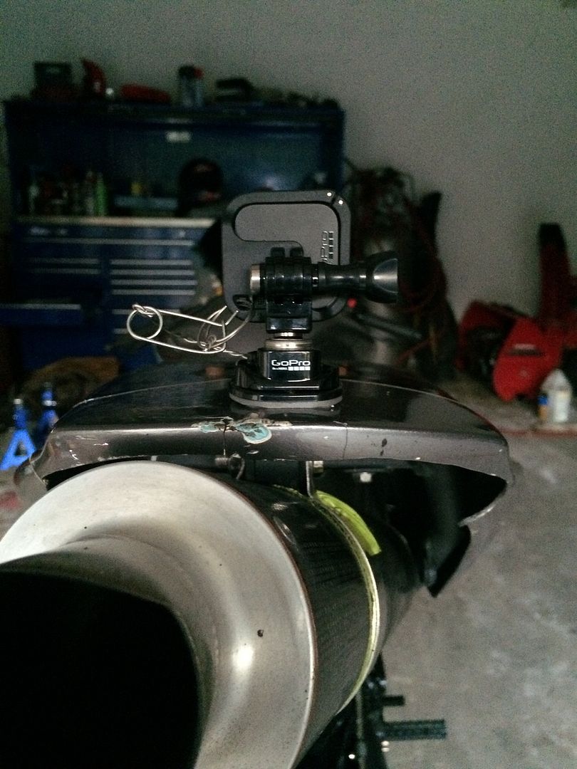

I wired up my new car for trailer lights, added 2 chocks and a storage box to my trailer, and mounted up my new gopro session to the tail of the bike this weekend as well. You can't tell, but I actually have drilled a hole through the front and rear of the sticky mount, carved out a small channel between the two holes to fit a piece of safety wire, and have ran a piece of safety wire in the channel and through the two hole securing the mount itself to the tail fairing. That all links into the piece of wire running to the quick release clip to the camera and voila.
