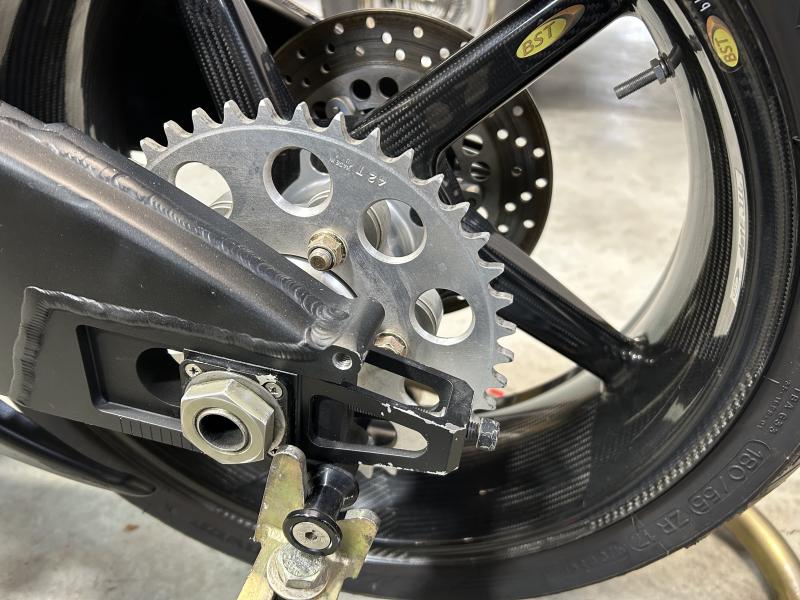

Also removed the rear wheel so I could remove the paint from the chain adjusters… there aren’t even any sand chips in the swingarm from the rear wheel. Just confirms the low miles on this thing.

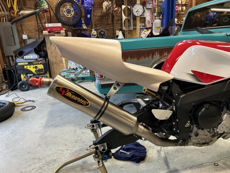

Took the exhaust system off and reinstalled it correctly, and using the OE mounting brackets. It was all installed wrong, using the. wrong brackets and hardware. Now all the pipes clear the engine and suspension, and the silencer lines up with the body lines of the tail section better.

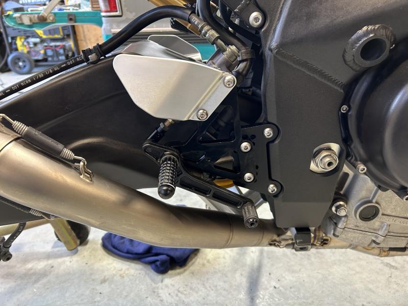

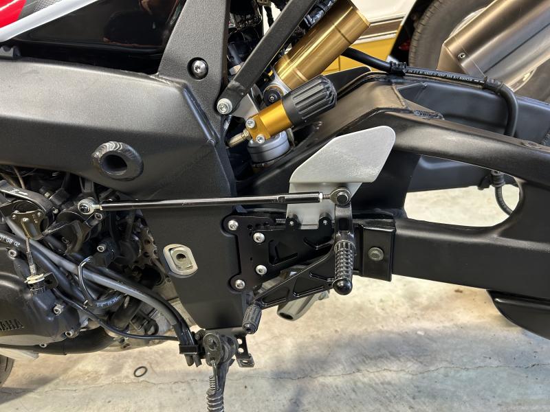

Next, I wanted to put the original levers back on the rear sets. I took both rear sets apart, cleaned everything, greased the pivot points, installed the rear brake light switch, and was able to find the missing shift rod ends. Both rear sets are now functional in the same way they came from the factory.

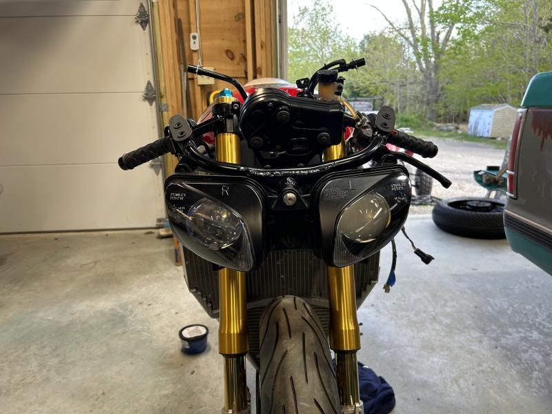

The headlight stay was also mounted incorrectly, and with the incorrect hardware. I removed all the washers, nuts and bolts, and installed the correct tab that had the 2 bolts welded to it. Installed the headlight assembly once the front stay was lined up properly.
Attachment 59444
