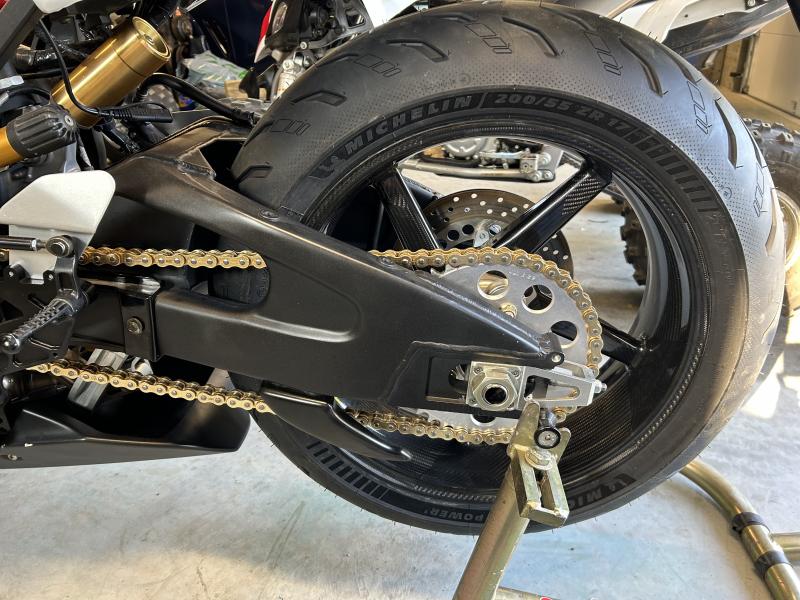

I had some tinker time yesterday with the rainy day and spent a few hours working on the bike. Mounted a new rear hoop and put on a new chain. The bike had the 520 conversion new sprockets already, so I bought the 520 chain. Of course whoever installed the front sprocket, put it on backwards.
Attachment 59531
