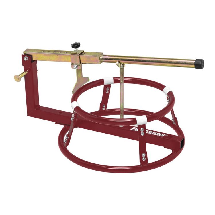

    I've not used it, but I really wonder if something like this bikemaster stand wouldn't be good 'nuf.
    Bare minimum to do tire changes?-bike_master_tire_change_stand_with_bead_breaker_750x750-jpg
    Figure out a way to clamp or bolt it to your workbench and just use irons. Has a breaker too. Way cheaper than my HF setup and takes up a lot less shop space when not in use...
