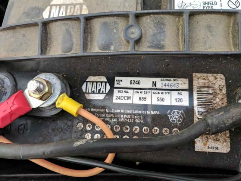

    Here's the battery:
    Which battery charger do I need for my marine battery in trailer?-img_20160916_211017-jpg
    What charger do I need for it? I look on Amazon and there seems to be a wide spectrum of chargers in terms of sophistication and cost - anywhere from $50 to $350.

    So, an update on this. I picked up the "NOCO genius" 7.2A charger, since it was well reviewed and seemed to be the most portable of the bunch. Plugged it into trailer battery which was completely flat and left out all winter (I know, bad). For several hours, it didn't do anything, and reading the booklet it came with, it was supposedly doing an auto diagnostic / desulphation routine. Then it kicked on, and a day and a half later, it now says battery is fully charged. The lights inside trailer didn't work for some reason and neither did my ceiling fan, so I couldn't verify. I need to troubleshoot that - wonder if I blew a fuse or something?
    Overall, I am happy with this unit. Came with a nice quick disconnect pigtail with a weatherproof cover on it. Was $93.
    Which battery charger do I need for my marine battery in trailer?-img_20170309_103536-jpg
    Here's my battery - A quick google search says it's a 75 AH battery, so a 7.2A charger should be right on the money jansmar.

    So that's a starting battery, not really a deep cycle. Don't expect it to stay charged too long with much draw. My RV came with an 85AH battery and it was horrible. I upgraded to two 230AH 6 volt golf cart batteries.
