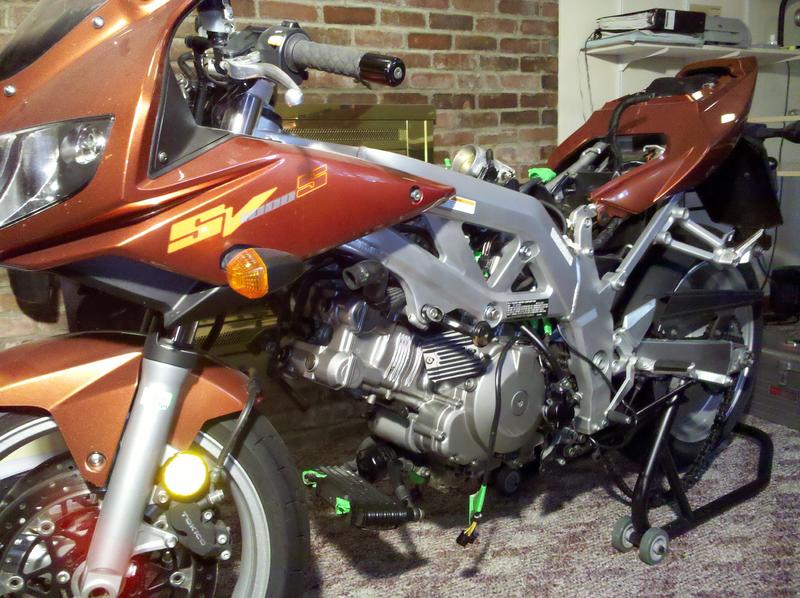

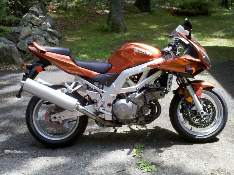

    So, two weeks ago, I got the motor in the frame. Last week I had it running and needed to replace the gasket at the front cam-chain tensioner. Today, I road-tested it and got it inspected.
    Coppah's baaack....-frankenmotor-frame-jpgCoppah's baaack....-inspected-road-tested-jpg
    Ready to RIDE!

    Yeah, I did a lot of research on the "knock" on the SV forums, too. This was definitely not that, and it was getting worse as time went on. Sure glad I got it remedied, though!
