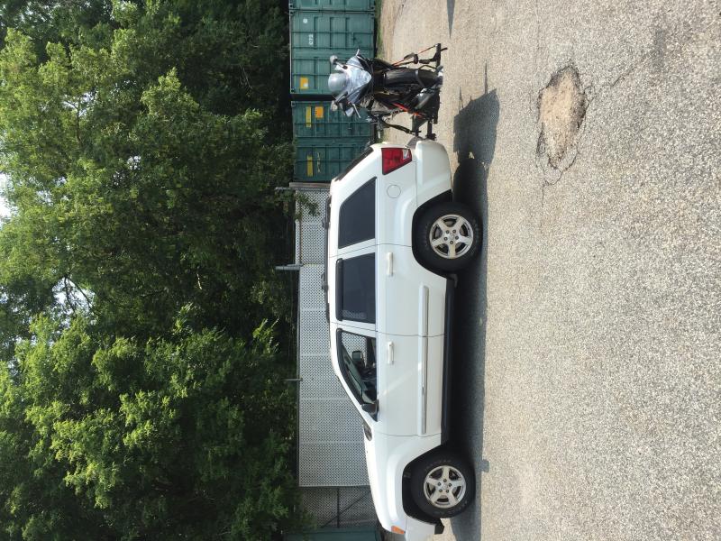

    I have one from discount ramps. I've used it with all 3 bikes. Farthest I traveled was NJMP with the gixxer. The 400lb street bikes put a ton of weight on the tongue plus an additional 100lb's of the carrier. With mine the bike sits about 2 feet from the hitch so if you can make an equation for foot pounds of leverage at that distance, I'm sure it may be over my 750lb tongue weight limit. I don't like carrying the street bikes anymore but the ktm it feels good. I can't win posting files in threads on a Mac. I have to edit the post to upload and then attach the file and sometimes they are upright and sometimes not lol.
    Attached Thumbnails Attached Thumbnails Hitch mount bike carriers-img_0699-jpg

    Quote Originally Posted by Jayspeed View Post
    that's ok, I can turn my laptop on it's side
    ya, you can definitely see the downward bend
