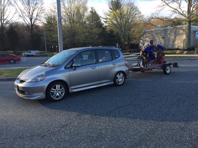

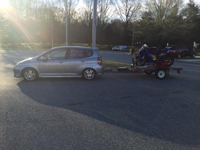

    I tow the ever-popular Harbor Freight folding trailer with my Honda Fit. I use a Condor chock rather than a TRS. Works just fine, though of course with a car that small you'll notice the load going up hills and acceleration is not great. Still gets ~30 mpg when towing.
    The trailer carries my bike, paddock stands, ramp, EZ-up and camp chairs, plus the trailer spare and tongue jack. All else goes in the car.
    I believe this is the cheapest possible way to get to the track.

    With the Condor I have no rigidity issues. I should note that the Condor model I have has a wide front beam, so that adds some rigidity.
    I use the usual front setup of ratchet straps run through the lower triple tree. On the rear I've set two flush-mount D rings into the deck on either side of the rear wheel. I run a strap through the wheel and those rings, which ensures that the rear won't go anywhere. The rear suspension is unloaded because I'm strapping down the rim only.
    The trailer is, of course, HF you-get-what-you-pay-for. But it does have the great benefit of fitting inside my garage.

    Thanks guys. The Fit tow setup is making me feel a little better, as the Impreza 2.0 reviews all compare the power output (not super favorably) to the Fit 1.6
