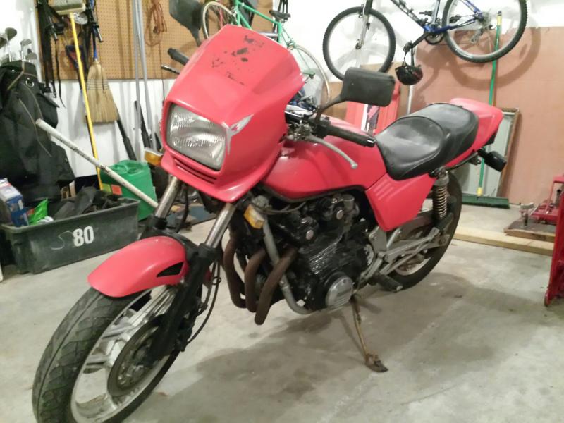

    Here's what it looked like when I first brought it home, a 1983 CB1100F Super Sport:
    My Latest Project - Completed!-20161220_192111-jpg

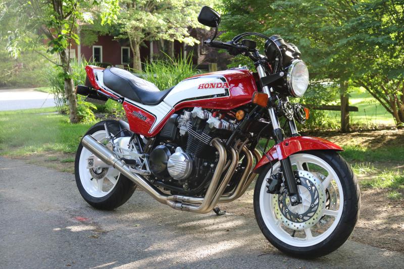

    And after a year of mostly sitting, followed by a year of work, here it is:
    My Latest Project - Completed!-img_0545-jpgMy Latest Project - Completed!-img_0561-jpgMy Latest Project - Completed!-kirk8-jpg
    Updates and mods include a rebuilt motor bored out to 1123 cc's with a Wiseco big bore kit. New intake and exhaust valves, chains, primary dampeners, etc. 2012 CBR600RR swingarm, 1992 VFR750F front end, 1992 CBR600F2 wheels, superbike bars, custom wiring harness, Ignitech ignition, Chris Lee custom stainless steel 4-into-1 exhaust, 2014 CB1100 controls, and much more.
    Except for the painted bodywork and some polished bits and pieces, I powder coated everything else myself, including the engine, frame, and wheels. Lots of time and effort, but well worth it, I think.
    It runs and rides like a dream.

    That's really cool. Great job with all the work! And thank you for ditching the square headlight.

    Friggen awesome man, beautiful bike!

    Great work, really nice attention to detail. Congrats on finishing the project.

    My eyes keep looking for the shocks...

    I'll post a picture tonight, showing the mono-shock if anyone is interested. The top part of the shock bolts into the swingarm shock tower and the lower linkage bolts up to brackets welded down below where the center stand used to be. It's braced up nice and solid.
    This is the way to go for a nice clean street fighter look, not to mention how much better the bike handles.

    Oh, I'm not knocking the build, just laughing as my brain says 'Hold up, I know that bike... something's missing... pay no attention to the swingarm shape...'

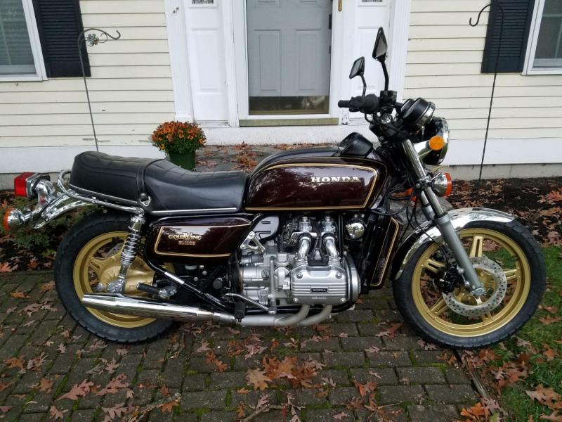

    I forgot to mention that I finished this bike last fall before I really dug into the 1123 Resto-Mod.
    My Latest Project - Completed!-10-13-18-jpg
