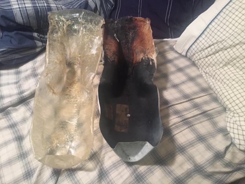

    Ok, so here's what I've got (white/black is original, unpainted is the newly molded piece):
    Some (very quick)  advice on Fiberglass (like, before this resin hardens quick)-img_2464-jpgSome (very quick)  advice on Fiberglass (like, before this resin hardens quick)-img_2465-jpgSome (very quick)  advice on Fiberglass (like, before this resin hardens quick)-img_2466-jpg

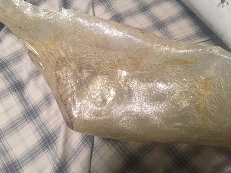

    So last night I had the idea of putting the belly pan on top of the exhaust, like it will sit when it's on the bike. That held the indented parts in place.
    Now, some of that is sort of rippley (third picture). I'm sort of torn on whether to cut those pieces out and re-form it with smaller pieces or whether I should just scuff it with 80 grit and put a second layer on as is (using smaller pieces that way too, but just not cutting anything away).
    You guys talked about getting all the air bubbles out when putting on another layer, but obviously if I fiberglass over the ripples there will be some air spaces. I know I'll sacrifice some strength, but I think it's *almost* strong enough with a single layer to do what it has to do. Just worried it might buckle under a full load of oil if it is ever needed. So the point being, I don't think structurally it will be bad if there are air spaces that I can't get out.
    Thoughts?

    I think that looks pretty good!
    1-Add a few more layers, especially on the thinner parts.
    2-Trim it up nice and clean with a dremel.
    3-Mock it up on the bike and pray it fits nicely...or that there is a enough flex to coax it into attaching.
    4-Toss some paint on it, and be done.
    Its the lower fairing on a race bike, I don't think you need super duper strength. I doubt a couple air bubbles is gonna kill ya. But considering this is an 1199 expect huge amounts of ridicule since you decided to make something to go racing instead of spending ridiculous amounts of money.

    I would not sweat having air "bubbles". I would avoid having air pockets. But small bubbles aren't that much of a problem in my opinion.
    If you are that concerned about applying another layer and getting it to bond, I wonder if you could skim the part with filler to smooth it out and avoid having cavities between the layers. Would the resin bond to the filler? I bet it would.
