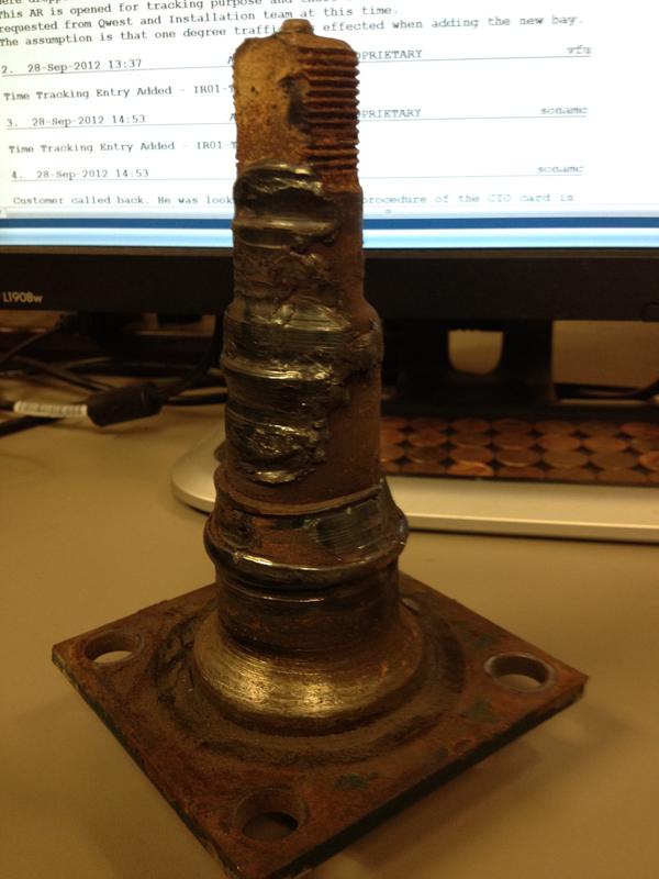

    Pump in just less than the amount necessary to blow out the seals on the back of the hubs.

    If your spindles look like this, the bearings may be running a bit dry.REMINDER - trailer bearings-091-jpg
