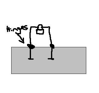

    Heres my idea.
    Something you could probably have a machine shop or welding shop fab up fairly easily, maybe. Have 2 "L" brackets made of 1/4" or larger steel plate that are hinged on the long end of the arms, and on the other side of the hinge, have something to sink into the ground and cover in concrete. Then on the short arms, maybe 2 overlapping rings that you could put a lock through. So you back your rear tire into the middle of the L's, swing them together and lock at the top, assuming your rims are open enough to accomodate them. Then you dont have to worry about having a chain cut, and you could probably position/cover the lock in a way that getting bolt cutters onto it would be nearly impossible?
    PIC of fantasticly terrible idea.
