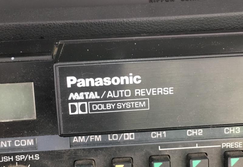

Attachment 48018

Found a blown 2.5amp fuse. Replaced it and the clock works!
Found that the intercom was disconnected at the internal connector. No need for it anyways.
Pulled apart the "tone" and auto volume box. Cleaned the pots with electronic contact cleaner, now no more crackling when turning the dial.
Found some Polk Audio 4" speakers that I had in my old college car in a box in the basement. Tossed them in. Right one still crackles a bit, likely the amp in the stock radio. Completely usable as it is though.
Cleaned the handlebar mounted mute/tuning switch box with electrical contact cleaner. Now I can tune up AND down.
