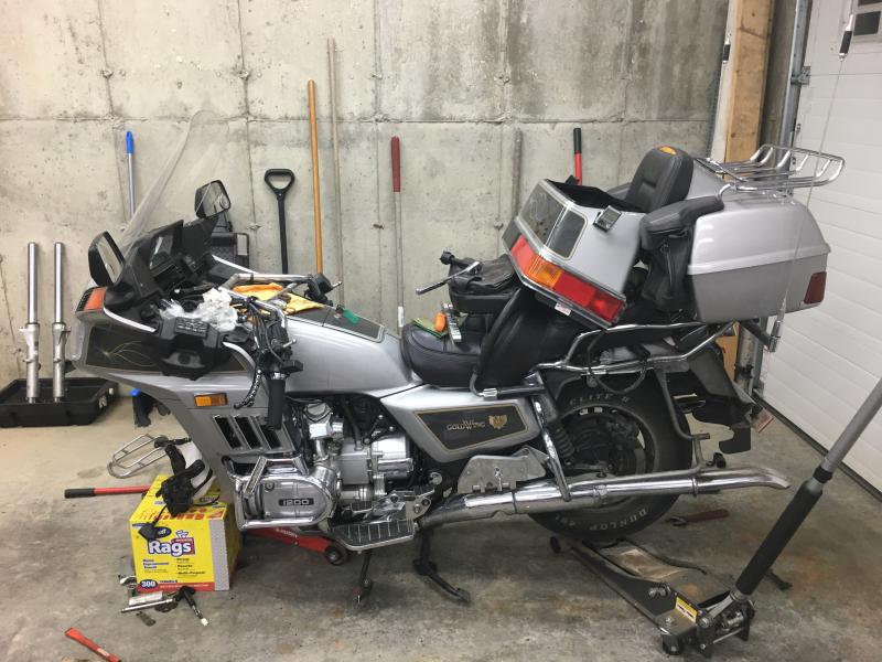

Sweet! Special socket came in early, hopefully doing the steering head bearings tonight.
Man, what a PITA it is to get the rear wheel off....

New castle socket worked mint. Also works for taking the swingarm off my Wee and SV, bonus!

Got the front wheel bearings out last night thanks to my neighbors blind hole bearing puller. Steering stem is in the freezer with the new wheel bearings waiting for more of my free time.
Hoping to get it together by the weekend.
Just as I feared, right rear wheel bearing was toast and the hub where the bearing sits is fucked from wear. No wonder the PO tightened the shit out of the axle.

Looks like I'm in the market for a wheel.
Just buy some shim stock and cut to fit?
Not sure of the exact situation, but can you use some green loctite to retain the bearing?
I've got a little bottle of 648 on my desk just gave me the idea.
I'd need to machine the wheel to assure centered bearing either way.
The "proper" fix for this is to swap a GL1500 rear wheel/final drive. They corrected the bearing offset issue by then.
Gah! The hidden surprises of old used bikes...
If I can find a used wheel from an '86/87 GL1200 where the bearing hasn't spin or enlarged the hub, I could use the green loctite stuff when I install the fresh bearings.
I just fixed a honda 150 with this issue. I just cut a brass shim, wrapped the outer race, and tapped the bearing in. Bob's you uncle. without the shim the bearing just fell in/out of the boss.
I bought a pack that had a variety from .001 up. I used the smallest size, and maybe could have gone up one.
