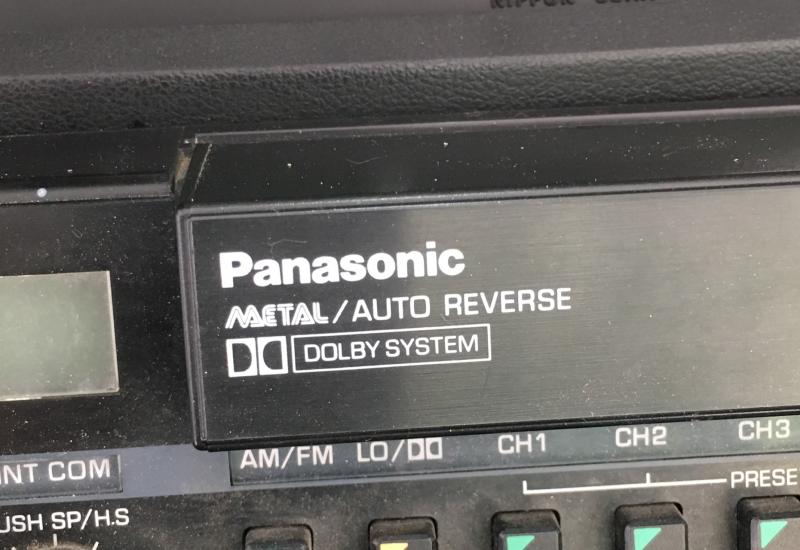

    You can still find Maxell MX-S and Sony Super Metal Master tapes on ebay. They may be overkill for a bike radio though.
    Y'all feelin pretty dumb now, eh?
    I present to you, SS LandWhale-img_1550-jpg
