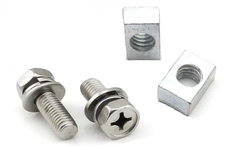

I'm curious how you are powering your heated gear. I use my trickle charger cord with its inline fuse. I use an adapter cord to the Battery Tender plug. Works great! Also SWITCH OUT BATTERY BOLTS to locking washer MXer style bolts. I had my battery bolts loosen a couple times and finally went with the locking style washer/bolt
Can you post a picture of these? Thanks!
These have a lock nut washer in them. Probably could go to hardware store and just get that washer...
Attachment 54375
https://www.amazon.com/Scooter-Batte...99823812&psc=1

That's what mine look like right now. Thanks!
