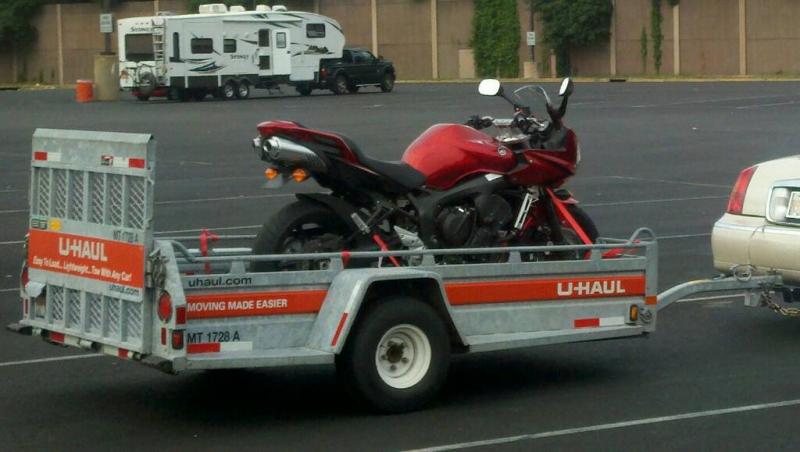

    If using the uhaul specific motorcycle trailer, there are plenty of tie down points for the front and rear. I just used the rear pegs when I picked up my FZ. I suggest securing front and rear of the bike in this trailer as it does like to bounce.
    I do not secure the rear when using my own trailer.
    Need to trailer bike - Uhaul?-uploadfromtaptalk1409076913997-jpg

    Is that a Lincoln? If so, shouldn't you be towing a Goldwing?

    Yup, got the Town Car when my father passed. Unfortunately, I had to sell it. That thing was so comfortable.
