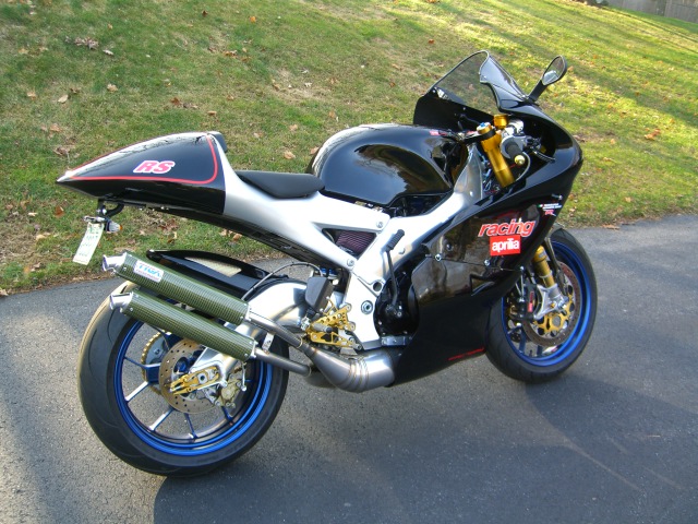

    Trick RD 400.-rs500_side9-jpg
    here is another one...aprilia 250 frame.... checkout the banshee forums(planet sand as well)...those guys have a great writeup on a guy doing a reverse cyl setup....tons of machine work etc... pipes get interesting.... stick with the banshee motor...tons of power...cheap to build. rd400 might be to weak of a chassis time you get done with your hard work!! Take your time and do it in a nicer chassis...the cool part about the twins is they fit in almost any chassis!! good luck and have fun!
    side note.... thanks sheppo.... that little red bike was very fun...the new aprilia is mucho more fun LOL. 290lb and 100 plus hp...
