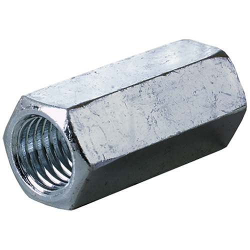

    BTW, I discovered that not many people have a 22mm hex to remove the front axle. A 22mm hex socket is usually 3/4" drive. Some BMW's are also 22mm, don't know what else.
    Cruztools to the rescue - ordered for $10.
    I used a threaded coupler, then just use a regular socket to turn it. Cost about $2.

    Quote Originally Posted by caddydaddy View Post
    Looks like this:
    Triumph service options-11011374_coupling_nuts-jpg
    For what size? Where did you buy it?
