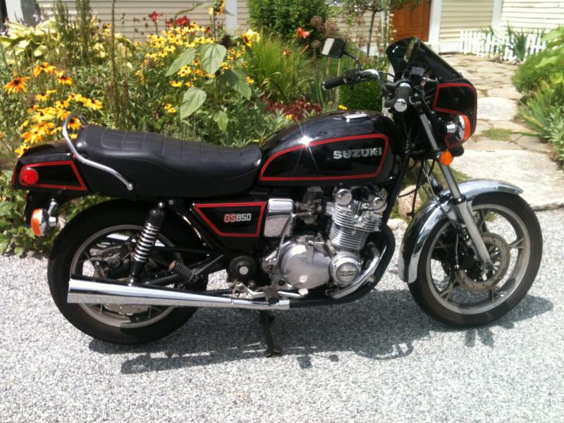

    That '79 sure looks gooooood. Almost too good. Nice to see someone kept it in good shape.
    I'm gonna throw the battery in mine this weekend although the weather doesn't look great for Sunday.
