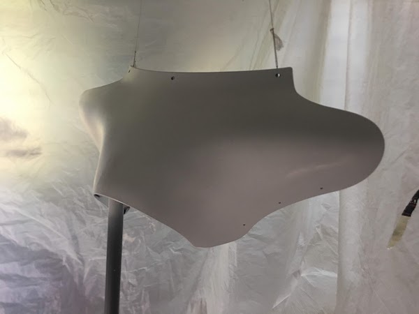

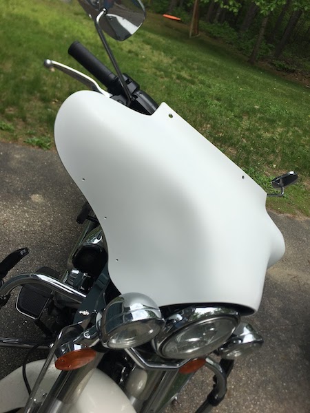

2 Attachment(s)
Re: Wrapping bodywork instead of painting...
Quote:
Originally Posted by
Teamdineen
This is the direction I wound up going.. and I'm pretty pleased with the results so far. Not bad for the money.
Attachment 50963
Attachment 50964
I now want to do all the tins this way.
I have a couple cans of black and intend to pull some of the chromed trim bits off and give that a whirl as well.
