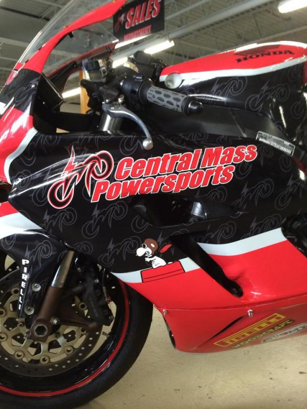

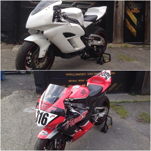

    My bikes were all wrapped by TSS Graphics.
    Doug did a great job and I think a ballpark of around $400-$600 depending on brand of bike is what he told me.
    His number is 978-562-1300.
