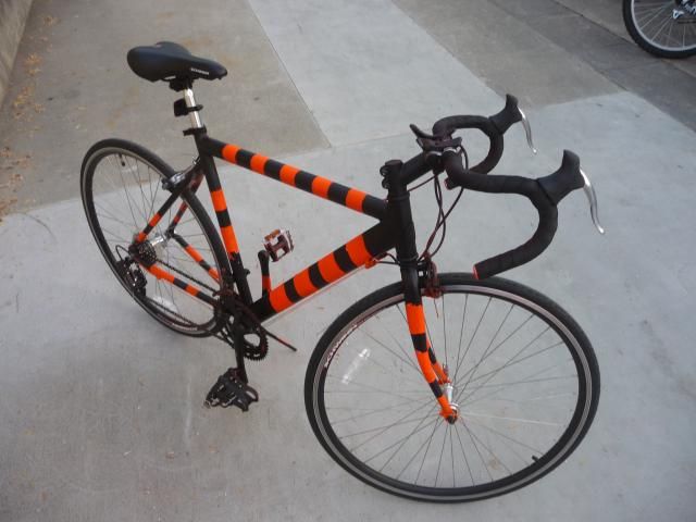

    It will look JUST like that... til the next morning. when it will look like this:
    Wrapping bodywork instead of painting...-fnuvmzlfwbno768-jpg
    Attached Thumbnails Attached Thumbnails Wrapping bodywork instead of painting...-fnuvmzlfwbno768-jpg
