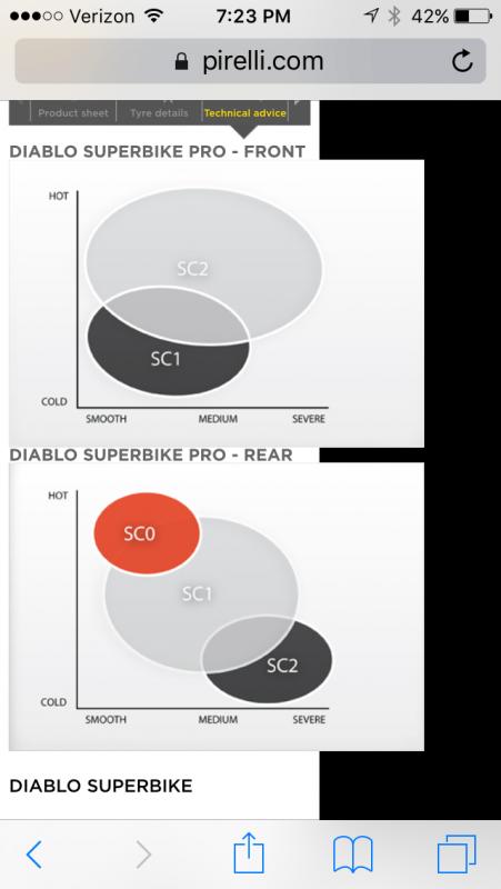

    You are both right. For hot temps harder front and softer rear. For cold temps softer front and harder rear.

    Quote Originally Posted by Dayon View Post
    160 DOT race tire options-image-jpg
    Thank you. That would have been extremely helpful to know the two years I was racing and buying Pirellis. I pretty much always ran the opposite of that.
    We have always encouraged riders to try the different compounds and decide for themselves... a simple chart is not going to work for everyone's riding style.
    We have some that swear by one compound, while others are just as adamant about the other.
