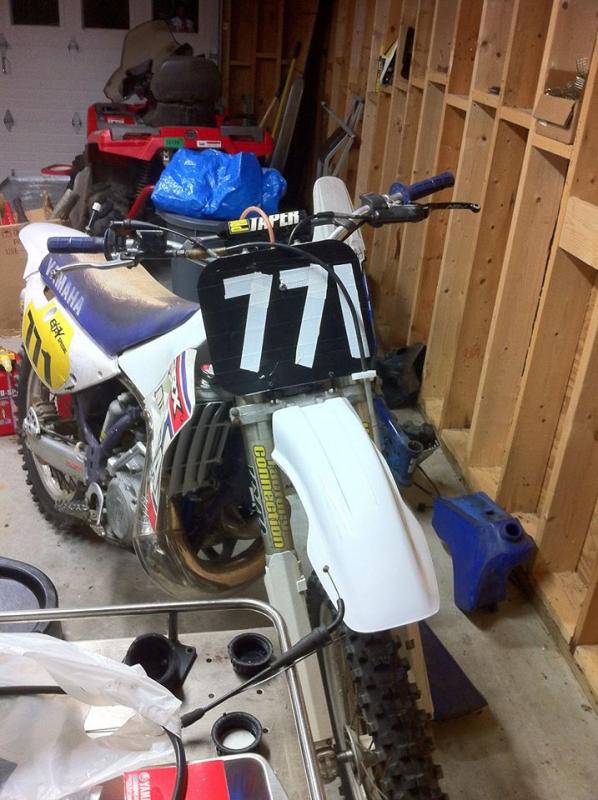

    Pics? Pics!
    Bring out your dead!-10536647_458023311005356_2975626331807247061_o-jpg
    Bring out your dead!-photo-1-jpg
    Obviously this is a done deal, I have stickers!
    Bring out your dead!-photo-2-jpg
    Bring out your dead!-photo-3-jpg

    Re: Bring out your dead!
    what bout the rest of the bike?
    r&r the bearings?
    brakes?!?
