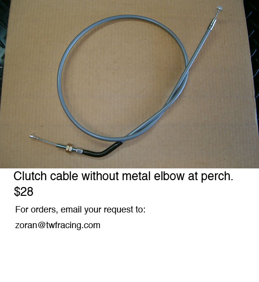

    Well, in the future, you can also try this:
    http://www.twfracing.com/images/zpar...le%20003bg.jpg
    I got one for the SV, and it works great. Instead of the elbow dropping it down, I had to route the straight cable around the steering head and back to the left side.
    The elbow at the other end wouldn't work on my setup, but nice to know about the option.

    The one I got from Zoran is actually a MotionPro.
