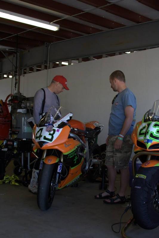

    Re: GSXR 06/07 Tail Mount on 1st gen SV
    GSXR 06/07 Tail Mount on 1st gen SV-1017243_10151748227358413_326012059_n-jpg
    That is the best picture I have. It isnt terribly difficult to do. You will need to trim away some of the bottom of the tail section as the SV subframe spurs are wider than the GSXR. Once that is done you just need to use a flat piece of aluminum bar stock to make your hoop.
