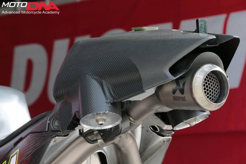

    After doing more reading, I completely forgot that Renault F1 had designed a suspension system that utilized mass dampers.... allowed at first, then Ferrari started crying about it so, banned.
    Here's an example of the Ducati tail section
    Oversuspension-ulgc9z9-jpg
    Now that I understand how the device works, I could see how a rider would benefit from it by suppressing swingarm/ chassis attenuation.
    It sounds like the device isn't designed to cancel out all attenuation, just attenuation within a specific frequency range, hence the adjustment that's designed into it.
    In architecture, this is known as a seismic damper and if you compare the size of any given structure to the size of the damper used within that structure, one could easily say there's no way something that small could affect an entire building.
    I doubt I'll ever be riding at a level where I could form an opinion on this device but the science and physics of it make sense.
