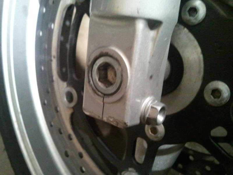

I just wired the pinch bolt. I think by rights you should wire the axle too by getting a hole through there, but they don't say anything at tech.
Do you know off the top of your head what you wired that pinch bolt to?
Wire the bolt TO the axle! :D Plenty of meat to do an angle hole into the axle, and pinch bolt. Just arrange so when wired they're tightening each other.
http://i47.photobucket.com/albums/f1...B8AE4CC0D9.jpg
This is how I do it Drill a hole diagonally through the fork leg into the axle..
I did it as Kurlon suggested, thanks guys. Do I need to do the rear brake caliper mounting bolts? The way I'm reading the rulebook, yes, hoping you all know something I don't.
Bike is all drilled for wire. I didn't break a bit until the last bolt, then apparently saved the best for last and broke 5 on the last bolt. Ended up going through the last 2 free adjacent sides with my last bit for the clutch win! Screwed it in, torqued it down, and got lucky with the functional holes in the right spot. On to bodywork.
