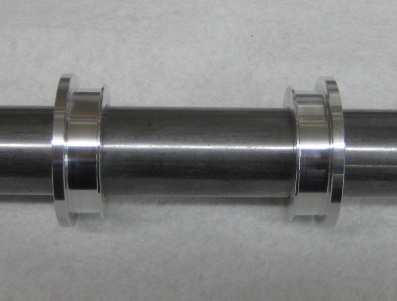

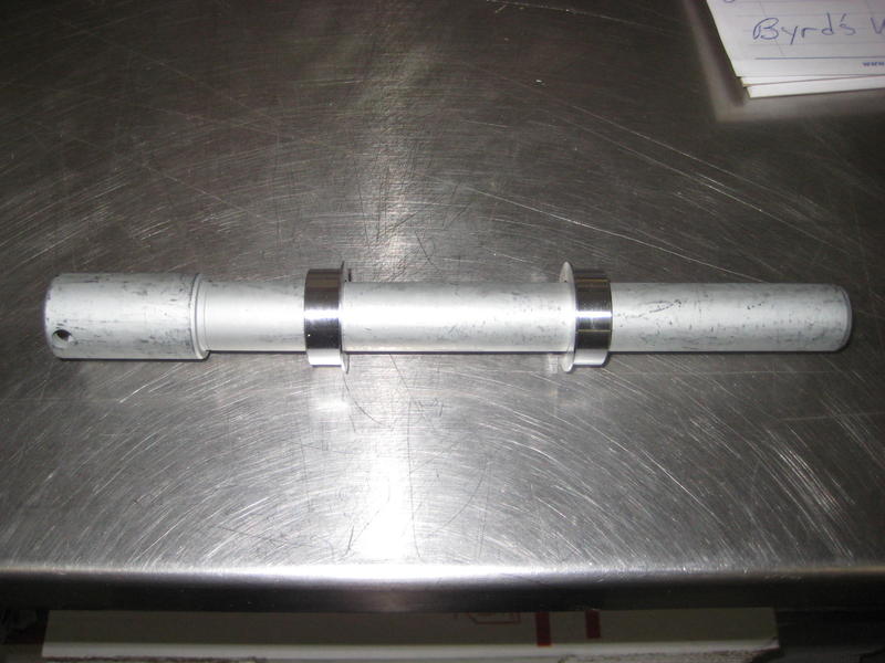

    sounds like you aren't designing them right. are you making a lip on the inside that fits behind the seals?
    the captive spacers I have are from Ten Kate Racing as they were the only ones at the time that made them for a cbr600. I like the beveled outer edge much better than flat edges.
    here's pics of mine (I only have rears) and ones that FastFrank Racing makes, both have the inner lip to be held by the seal.
    Attached Thumbnails Attached Thumbnails Spacer Machining-photo-jpg   Spacer Machining-cbr600rear-spacers-jpg   Spacer Machining-cbr600-front-spacers-jpg

    I don't run seals, so I don't set the spacer up to catch them. (That also seems like a good way to tear a dust seal by accident.) I'm going from a wheel setup for a 22mm axle to a 17mm axle, so instead the spacer has an inner portion that goes inside the 22mm bearing and supports the spacer between the bearings like the axle would. (My OEM wheels are actually setup this way also out of the crate.) The problem I had is I don't have the proper tool for measuring OD / ID, so the numbers I got with my caliper plus what I was told should be proper clearance turned out to be off. I was able to polish the ID of one to get it close to a slip fit on the axle so I'm not THAT far off...
