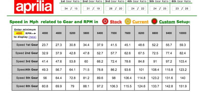

    That's helpful. The 1199 Redlines at 750 rpms higher than either of those, so it's not an exact comparison, but 15/42 on the Aprilia seems to be pretty close to 14/42 on the 1199.
    ...you sound kind of unsure on the RC8 though...if I'm reading the gearing commander correctly, it's showing stock gearing at 17/37......and 15/44 would only put you at 119.1mph at the end of the straight, redlined (10K rpm) in 5th gear.
    Tips on gearing a big v-twin for Loudon-1199-14-42-jpgTips on gearing a big v-twin for Loudon-rc-8-15-44-jpgTips on gearing a big v-twin for Loudon-rsvr-15-42-jpg
    I was/am. Looking at the specs it says 16/38 for the RC8rs stock. The speedometer is driven off the front wheel and claims 135-136 top speed at Loudon. I think I'm running it up to 10,500 rpm. After thinking about it, I may not be getting out of 4th gear on the track. It doesn't have a gear indicator, and I don't pay much attention. I guess I'm probably not much help on the gearing, or what gear I'm in, but I know where I shift.
