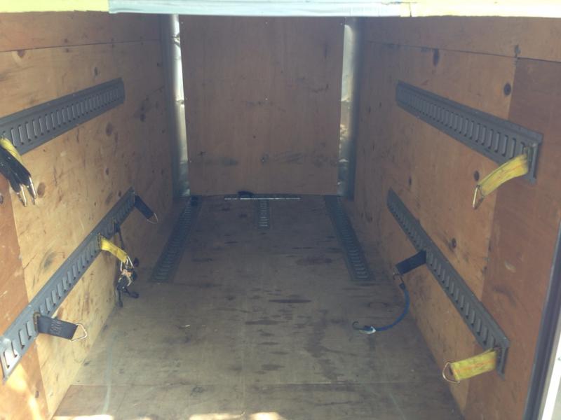

    Interior: Pit bull TRS for my bike and a Condor/Etrack setup for a second bike. Shelving/work bench area at the front of the trailer where I can roll a tool box in/out of, stash gear, and generally organize "stuff" for easy access. Upgrade interior lighting. New decking and walls that look pretty. Probably do a checkered flag vinyl floor.

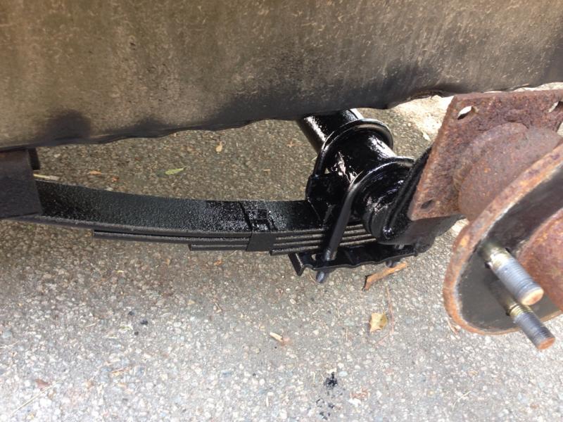

    Some new hubs and some paint and it'll be ready for many more miles Track Trailer Build

    Fresh paint going on today. Not enough time to break out the welder today so I'm just going to blast everything except the tongue and do the fab work when I have a full day. Finished pics to follow.

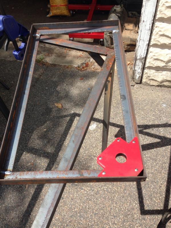

    Getting the metal fab work done today. Started with a stock of 1.5x1/8" angle and layed out the fuel can and propane cylinder.
    Track Trailer Build-imageuploadedbytapatalk1407166026-570419-jpg

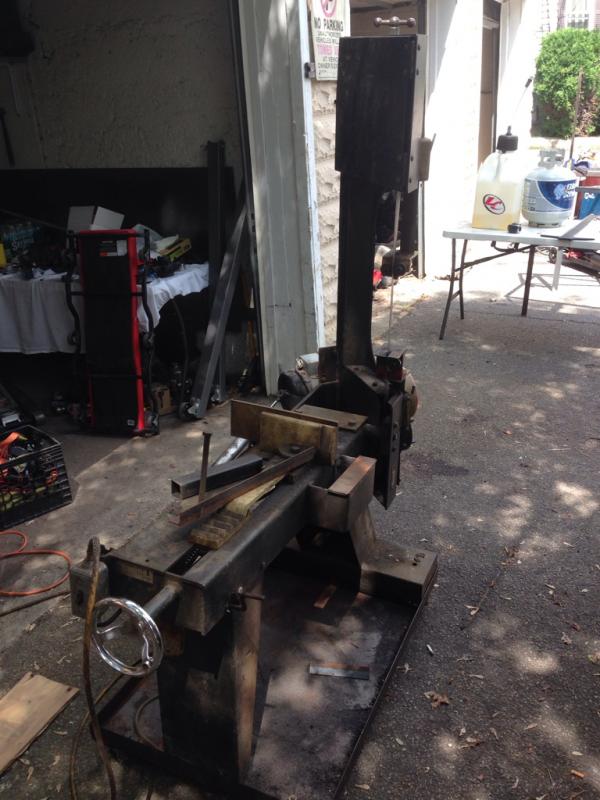

    Picked up a 7" band saw for the shop for $150 a few weeks ago, decided to skip the fancy miter cuts and cut the outer frame pieces
    Track Trailer Build-imageuploadedbytapatalk1407166097-408143-jpg
    Used a magnetic square, fit the pieces together, and welded. Some finish welding left to do.
    Track Trailer Build-imageuploadedbytapatalk1407166148-899287-jpg
    A little bit rusty on the torch but it'll stick just fine. Next is to get a few crossmembers set and put together the feet for each of the fuel containers out of some 10 ga sheet metal. More to follow.

    Very jealous of that fabrication setup.. never mind the skills and knowledge to use it.
    Thank you, sir. The fab setup has been built up over the years. When I started jeeping years ago I found out quickly I'd need to learn to weld and fab or it would be a very expensive hobby. I'm not setup to do aluminum yet, but one of these days I'm going to bite the bullet and buy a TIG rig. MIG is pretty easy, I taught myself to weld in a couple of evenings of burning scrap together. Pretty sure I'm doing it right at this point, I've beat the shit out of my jeeps without a failed weld yet. The fab side isn't real difficult either, a few good measuring tools and some common sense goes a long way for the level of difficulty I'm tackling.

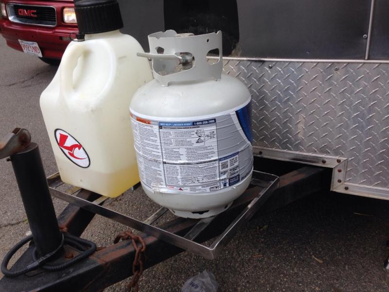

    Bracket has been finish welded, ground smooth, and test fit on the tongue...should have made it a few inches wider, but it'll work.
    Track Trailer Build-imageuploadedbytapatalk1407169276-192061-jpg
    Track Trailer Build-imageuploadedbytapatalk1407169327-158650-jpg

    You have a bandsaw that will cut metal? I'll be right over...

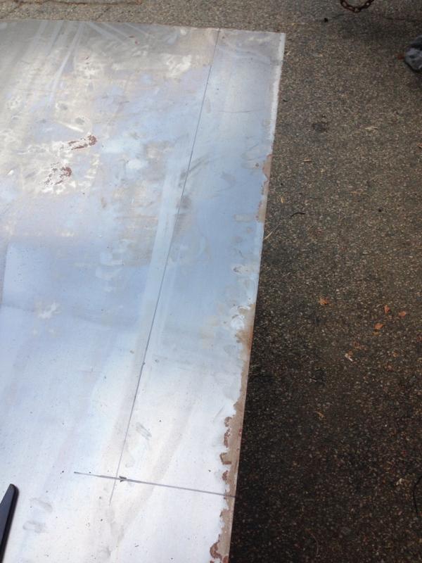

    So I had to cut 4 crossmembers for fuel container support out of some 1/4" plate I had at the shop.
    Track Trailer Build-imageuploadedbytapatalk1407172556-552388-jpg
    Track Trailer Build-imageuploadedbytapatalk1407172570-901250-jpg
    For those of you counting, I actually could have bought a piece of 1/8" flat bar and cut it to lengths for less money than the 3 1/2 cutting wheels I burned and hour it took to make these pieces. Boring ass work too. Anyway, it's done and it will work.

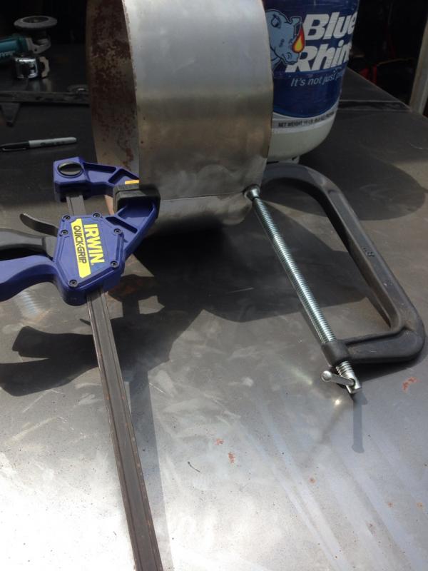

    Ok so next step was to make the footer for the propane cylinder. Bit of a bitch since it's round, oh well. Measured the circumference of the cylinder then cut out a strip 40x6" from some 20 ga sheet I had at the shop.
    Track Trailer Build-imageuploadedbytapatalk1407178714-524754-jpg
    Got it clamped together
    Track Trailer Build-imageuploadedbytapatalk1407178732-816569-jpg

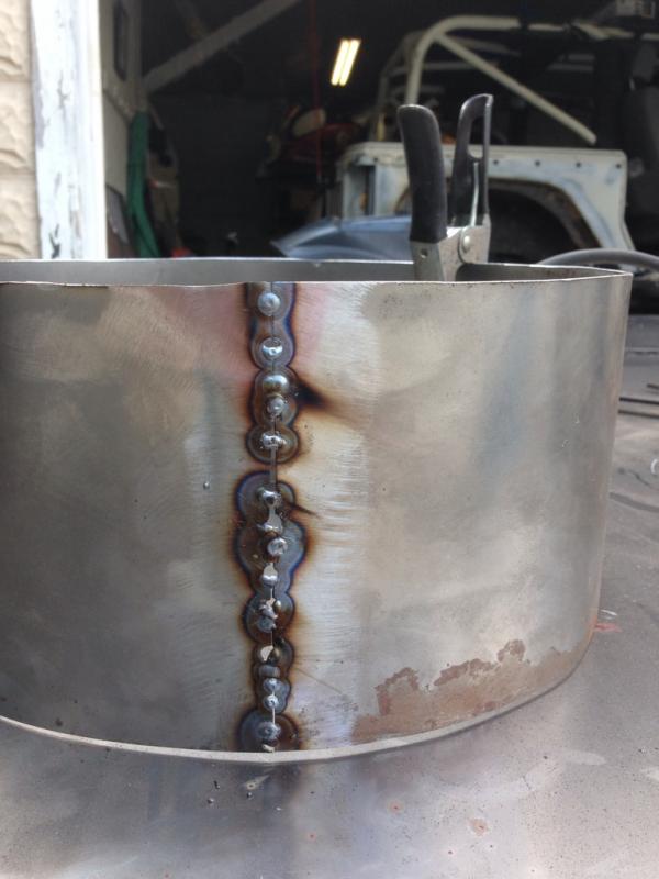

    Then started welding. Thick stuff is easy, with a MIG you might as well be squirting toothpaste. Some of you Maine boys probably find that concept challenging. Sheet metal is bitchy and is super easy to blow holes in so you run a series of tack welds
    Track Trailer Build-imageuploadedbytapatalk1407178846-516577-jpg
    Then you fill in the gaps
    Track Trailer Build-imageuploadedbytapatalk1407178864-548370-jpg
    And after some grinding and a bit more tacking and some more grinding you have a finished propane footer.
    Track Trailer Build-imageuploadedbytapatalk1407178903-240549-jpg
