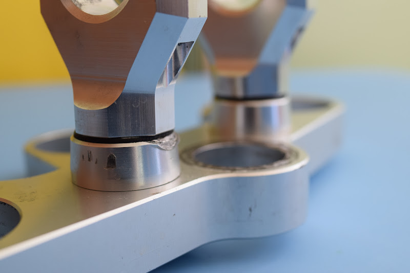

    Meanwhile I got a new top clamp installed tonight and the efing handlebars are still crooked (new handlebars too!)
    Can't believe I was so dumb not to check the top of the "U-clamp" that bad boy is twisted like a prop! On the old ones they came as 2 separate clamps but Gen 2 is one piece
    I actually thought the risers were damaged and the are not available separately from the clamp, when I called AF1 trying to get the part numbers for the riser insulators etc, they told me "bad news none of those parts are available separately, good news it's only $130"
    Win a little loose a little...

    Sep 2011
    Providence
    267
    Re: DIY how to re-key the lock
    Already replaced most expensive part because of this damage (see pics) first I replaced bent hardware, but when I saw crooked handlebars just assumed that risers were bent (rubber-mounted doh!)
    but turns out it's a 42$ part that was warped (already ordered from AF1)
