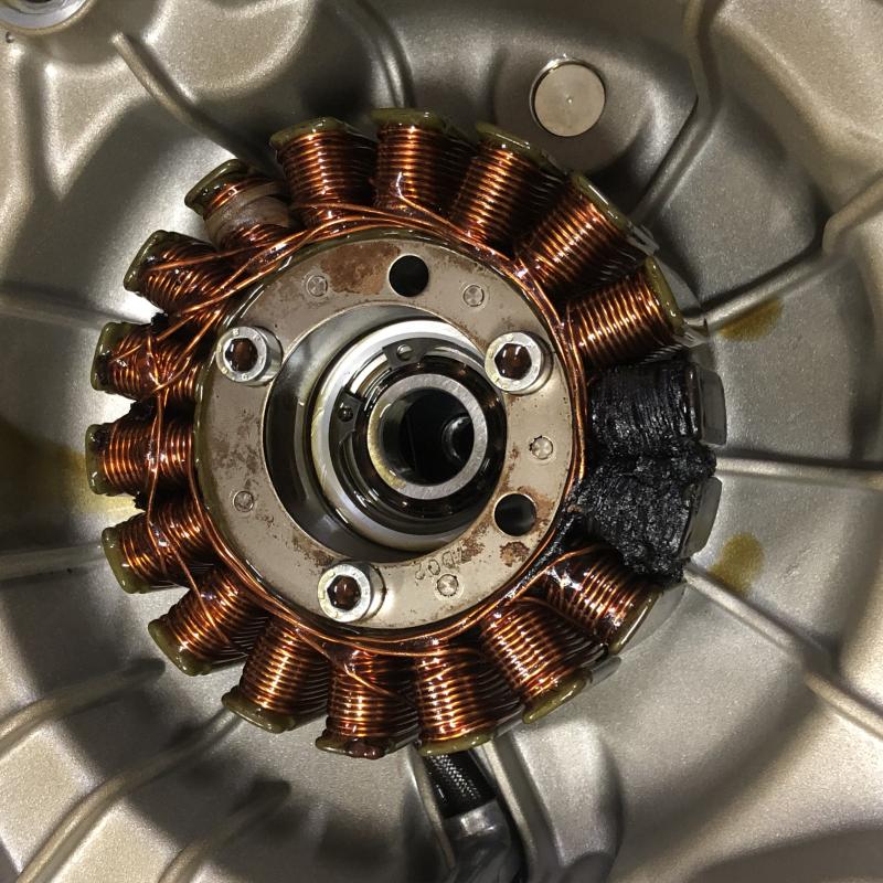

    Checked the stator, it’s shorted to ground, not good.
    Looks like it needs a new stator, will probably replace R/R with a MOSFET while I’m at it.

    Apparently Ducati used 3 different model stators, each a slightly different size, when they built this generation. So I need to remove the old one, measure it, order the right one, then wait for the new one to arrive before I can install it.

    Stator was shorted to ground. Removed the old one, got a new one on order from Rick's. Old stator is definitely NFG.
