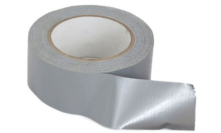

    This is for an EX right?
    Fiberglass repair.-ducttape-jpg
    6,994
    Re: Fiberglass repair.
    Just get the bondo fiberglass kit and some filler...... mat glass on the back and fill. Its just going to get some more pavement surfing anyways....
    Don't make it too good LOLOL
