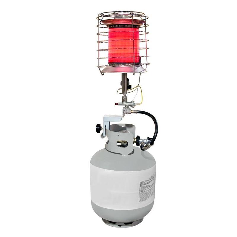

    These are what caught my eye at HD. Prices seem right.
    Garage Heat-c7950bfa-1f6c-455a-838a-437e0fde6608_1000-a
    http://www.homedepot.com/p/Dyna-Glo-...specifications
    Garage Heat-a873a8b5-b230-4893-b087-7f624551f50c_1000-a
    http://www.homedepot.com/p/Dyna-Glo-...N#.UpIaDcReZ8F

    #1 will heat faster, but is very noisey

    I've had one similar to the top one for many years. It works well to hear a small area very quickly; if there are drawbacks besides the noise, they are that:
    1) you need an area to aim it where nothing will catch fire
    2) it's not good for maintaining temperature, just heating it quickly. As a result, prepare to get your workspace too hot, turn it off, work till it gets too cold, then repeat. Size of room, insulation, and outside temp determine how often you repeat. It's not a "set it and forget it" type device, but it will heat the hell out of a cold single car garage in very short order.

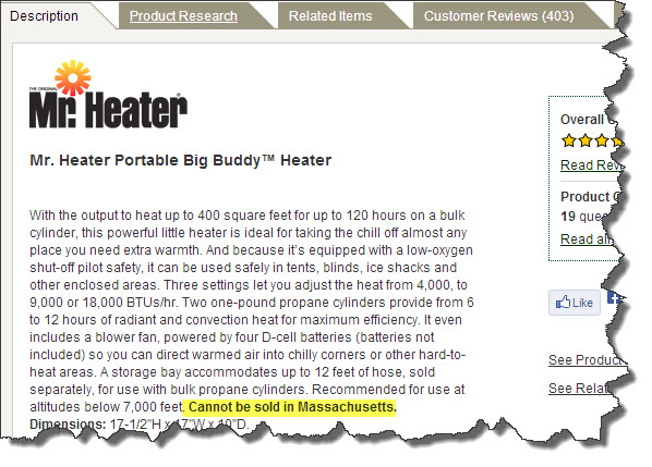

    I have a Big Buddy propane heater for I use for cold weather camping in a 9x12 tent. Just on the lowest setting (4.5k btu) it's almost too much. High setting is 18k btu. It's rated to be used in enclosed spaces. Pretty inexpensive at $125, then add an accessory hose to attach to a bulk propane bottle. Should be perfect for a single car garage.
    http://www.cabelas.com/product/Mr-He...ter/745033.uts

    That sounds perfect. I wonder why they say it can't be sold in Mass.

    You can spend more and get a Massachusetts approved one.
    http://www.amazon.com/Mr-Heater-MH18...d_sim_sbs_hg_3
    Another option might be if you knew someone who lived in NH and made regular trips to MA...

    They actually just won't ship it to mass. I had mine shipped to my Dad's place in NH. I was at Bass Pro in Foxboro a few months ago and they were on the shelfs there. The Commonwealth probably just wants to exact some stupid inspection fee to determine its "tent safe."

    So, the Big Buddy takes 4 D batteries?
    5,492
    Re: Garage Heat
    The batteries are for the blower, you can also plug it in with an AC adapter.
