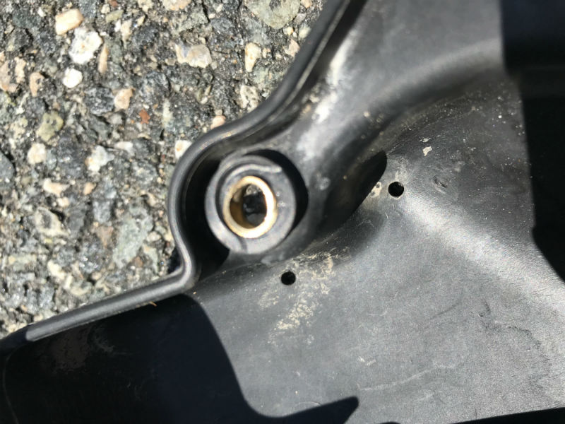

    After replacing the fuel filter and the thermistor for the low-fuel light, and installing a new o-ring for the flange that attaches the fuel pump to the bottom of the tank, I've got a new problem. Specifically, a fuel leak. When the bike is being stored.
    The strange thing is that if I run the bike for 5-10 minutes, there is no leak. But if I shut it off, and wait 15 minutes or so, it will start to leak. On this model Ducati, there is a large plastic cover that protects the quick-release fuel line connectors. With the flange cover on, you can't really tell where the leak is coming from. So I took the cover off to investigate. The first thing that I noticed was that one of the bolt bushings for the cover has become elongated, and is no longer flush with the rest of the cover:

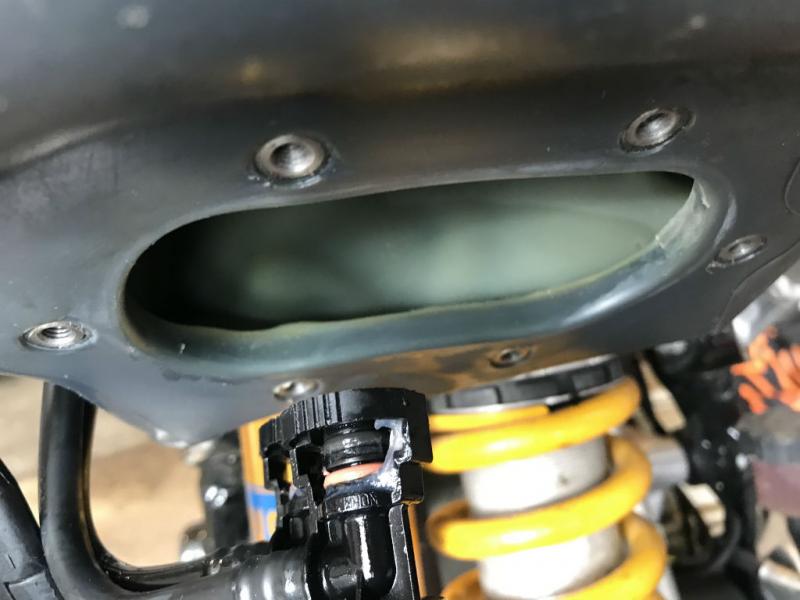

    The flange is attached to the tank with 6 (I think) bolts. 3 of them attach the flange to the tank directly, and the other 3 attach the cover to the tank and go through the flange. In other words, the cover being attached helps seal the flange to the tank. So a bent cover might be a problem, but I don't think it's my problem.
    I pulled the cover, and the tank seems pretty straight:
    HyperMotard gas tank leaking-img_3469-jpg

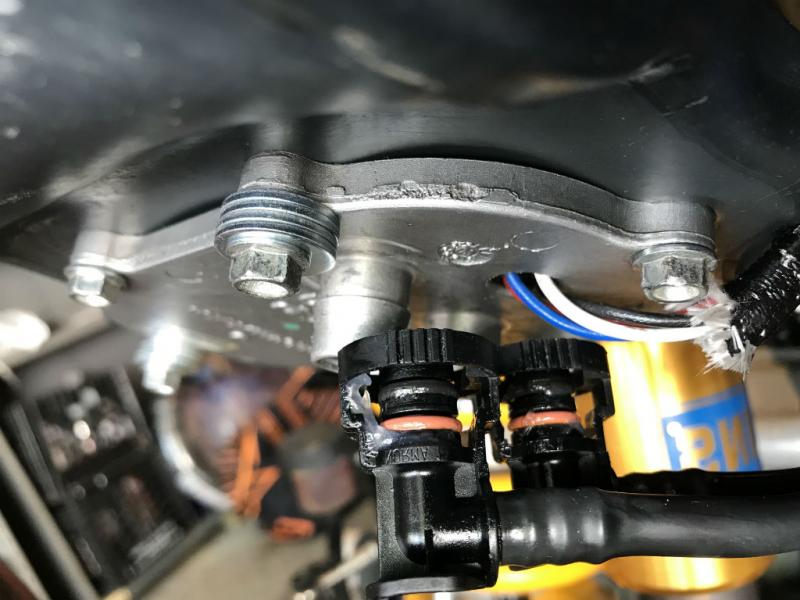

    (The gooey stuff is petroleum jelly for the o-rings.) Because some of the cover bolts are longer than others, and the holes in the tank are blind, I put together some washers to simulate the depth of the cover. That way I could use attach all six bolts to the tank without the cover being in place. Here's how it looks installed:
    HyperMotard gas tank leaking-img_3473-jpg
    The torque measurement for those bolts is only 5Nm. You can see from this photo that the flange doesn't appear flush with the bottom of the tank. I think the photo makes the gap look a little worse than it is, but still, it's not flush. There's also no gasket sealing the flange to the tank -- there's only an internal o-ring (which I replaced).
    I reinstalled the pump assembly, started the bike and no leaks. 5-10 minutes later, it started leaking slowly. If you look at the bolt in the top of this picture, you can see that it's wet with gas:
    HyperMotard gas tank leaking-img_3474-jpg
    You can't tell by the orientation of the photo, but that bolt is the near the lowest point in the tank, so it makes sense that that's where I'd see a leak.
    I don't know how to progress from here. The bike only has 8,000 miles, give or take, and so I find it hard that the tank is warped or needs replacement. What do you guys think? Ducati have had a problem with plastic tanks warping and swelling, so this could be the same issue, but the bike is 10 years old and I don't expect any help from Ducati NA.

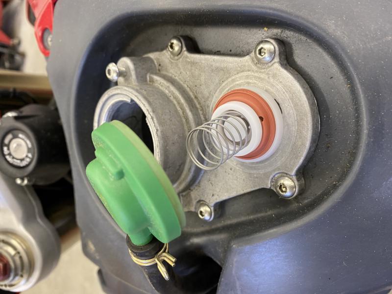

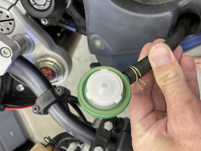

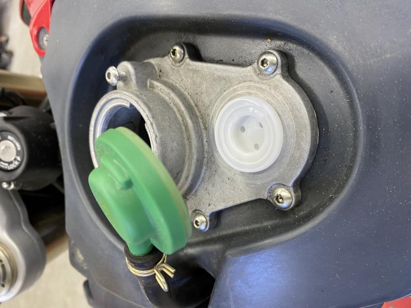

    Is anyone familiar with breather valves -- did I assemble this thing correctly? It came disassembled, with no instructions.
    HyperMotard gas tank leaking-img_8294-jpgHyperMotard gas tank leaking-img_8295-jpgHyperMotard gas tank leaking-img_8293-jpg
    I double-checked the hose and it is not clogged. When I put the breather together, I have to blow hard to get any air through it. Does that sound correct?
