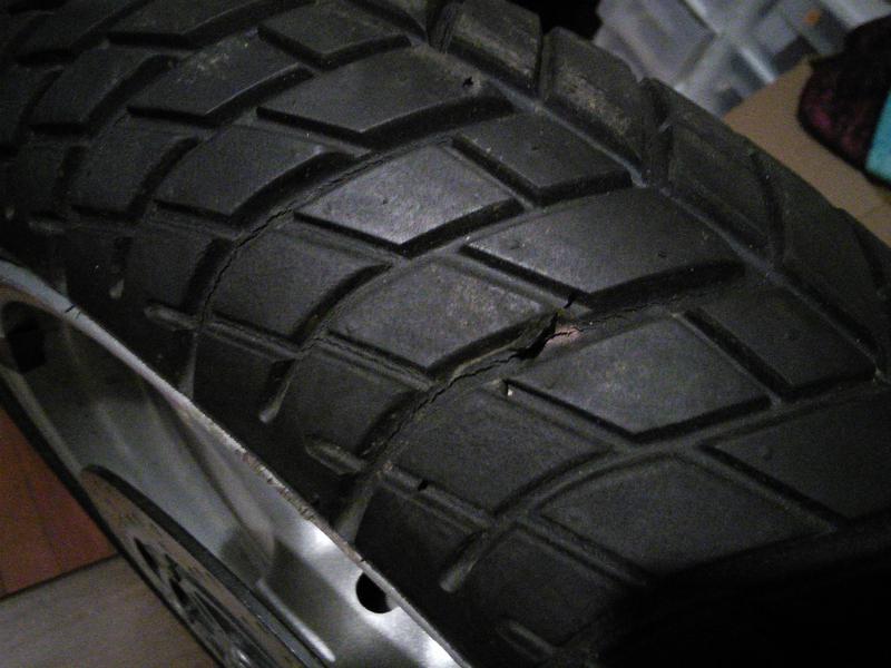

    I bought these "good condition" used rains from a dude on svrider. I'm thinking I should ask for my $ back as a disposal fee. Please offer input, not sure they are safe to ride on with this much rot, especially on the sidewall.

    I wouldn't use them...well maybe on a motard in the dirt.
    I did the same thing a few years ago, bought a set, got them home and inspected closer to find they were cracked just like those. Sent the guy a message, he sent me the money back and I tossed them in the trash

    I'd trash them. I've run tires with almost imperceptible cracks in the sidewalls when inflated and it was an unpleasant experience. As you're leaning the bike they behave normally to a point and then they tip dramatically. There's no way I'd run those.

    Good condition...in other words "nice from far but far from nice"

    Thanks guys, I'm pissed that I didn't back away as soon as I saw the old tread pattern in the pics the guy sent me initially. I just sent him a PM voicing my displeasure and hopefully not sounding like too much of a prick. Sucks that even if he gives a refund I'm still going to be out one way's shipping and wont have any rains.

    Oh hell no! Those are trash.

    Ill buy those rain tires if you don't want them. I use rains on 17s for flat track at wachusett valley riders club so a little dry rots not really a big deal to me.
